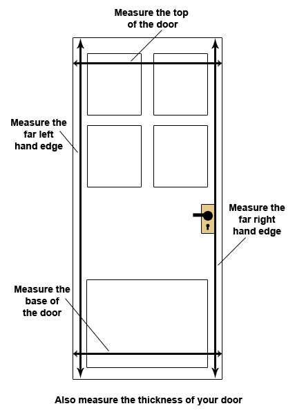

How to Measure an Internal Door
Ensure accurate measurements for replacing your internal door by measuring it in various places, considering potential frame shaping. Refer to the image below for guidance:
Guide on measuring an existing door for determining the size of a new door
Measure the thickness of your door; if the new replacement door is thicker, adjustments to hinge positions and door stops may be necessary, rather than a simple replacement. Common door thicknesses include:
